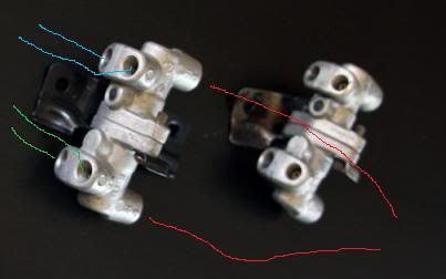

    Does anyone know if this is correct? Thanks fellas
    Red=MC
    Blue=front
    Green=back
    (blue and green can be reversed, does not matter just keep them together)
    Here:

    i would assume that since honda uses a diagonal split system, each "half" would control 1 front and 1 rear wheel - as in LF and RR, RF and LR.
    You're right - I have no idea what I'm talking about...

    Quote Originally Posted by georgieboi View Post
    Red=MC
    Blue=front
    Green=back
    Here:
    This diagram is incorrect, do not follow it I'll post up the correct way later
