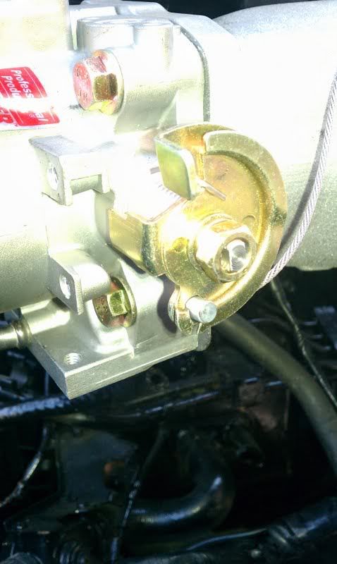

    It's for a GSR as you guys can see... where the throttle cable goes on the TB it turns the oppsite way so the cable does not even go on. I don't know if this can be solved or if I need a new Throttle body... what do you guys think?

    you either need the gsr throttle cable and bracket, or you can remove the cable "wheel" from the throttlebody and substitute a d-series one and use your current cable.

    goes like this, he is using a GSR throttle cable bracket

    Yup Yup.. You need a GSR bracket bud.
