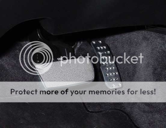

    master cylinder, slave cylinder, clutch lines, clutch, flywheel, new mounts (torque mount, conversion mount, and possibly rear mount)(at least on civics you do, not sure of preludes), probably a new center console, shifter, boot, knob, and time... and for clutch pedal, you probably need the entire assembly (clutch, brake, and gas pedal..)
    here is why.. you are going from pedals like this..
    to pedals like this..
    Notice the size difference in the brake pedal..
    if i think of anything else ill post up.. its not to bad of a swap as long as you make sure to have EVERYTHING before you start
