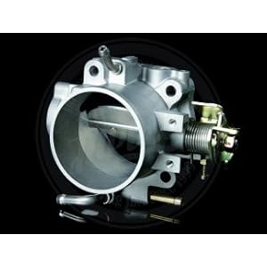

    Theres one more thing, i think it could be; possibly a dirty throttle body and dirty air filter. First off, make sure the air filter is good shape and clean. Then try cleaning the throttle body and reset the ecu by upluggin the ground cable off the negative terminal of the battery. If this doesnt work, then i dont know what else it is. I noticed that sometimes cleaning the throttle body, does help a car with bad idle and dead starts.
    So, simply:
    -Disconnect the negative cable off the battery
    -Next, detach the air intake assembly off the intake manifold so you can gain access to the butterfly valve or throttle plate (whatever you wanna call it) inside the throttle body, and clean the inside and edges of the plate.
    -If you see the picture above, grab a toothbrush and spray some throttle body carb cleaner (get some at advance auto, its like $3) and clean the edges of the plate and behind the plate. Make sure you open the throttle by pushing it or twisting the throttle latch where the throttle cable is located.
    -Get all or most of the built up gunk and carbon deposits off. Then wipe it down some more, by spraying some on a clean paper towel and dry it off.
    -Reattach the intake assembly.
    -Then reattach the negative cable on battery, this should help reset the ecu as well
    -Hope the car starts up good.
    Let me know if this helped, its worth the shot (your only spending like $3 for the carb throttle spray cleaner).
