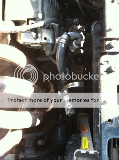

    Here is a picture of how I had mine.
    I would write up a how to but I'm on iPhone.

    Quote Originally Posted by Austin? View Post
    no offense, but how does that not leak!?!?!
