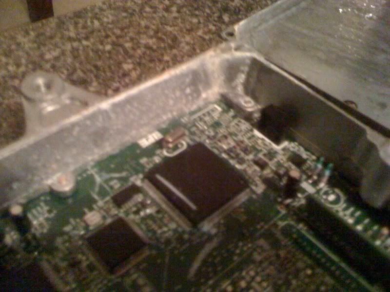

    pulled ecu out. and..... water came out of it... currently drying it. haha.

    mildew in my ecu.....haha

    thorough cleaning. runs like new.
