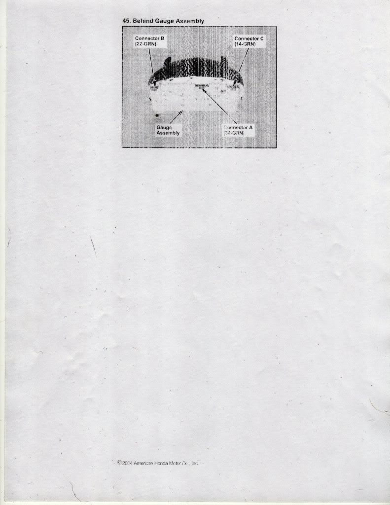

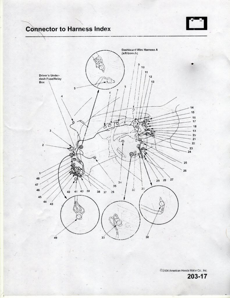

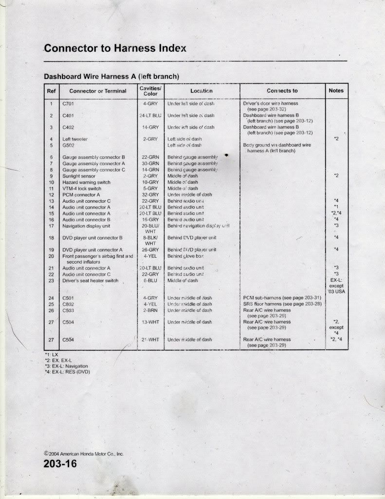

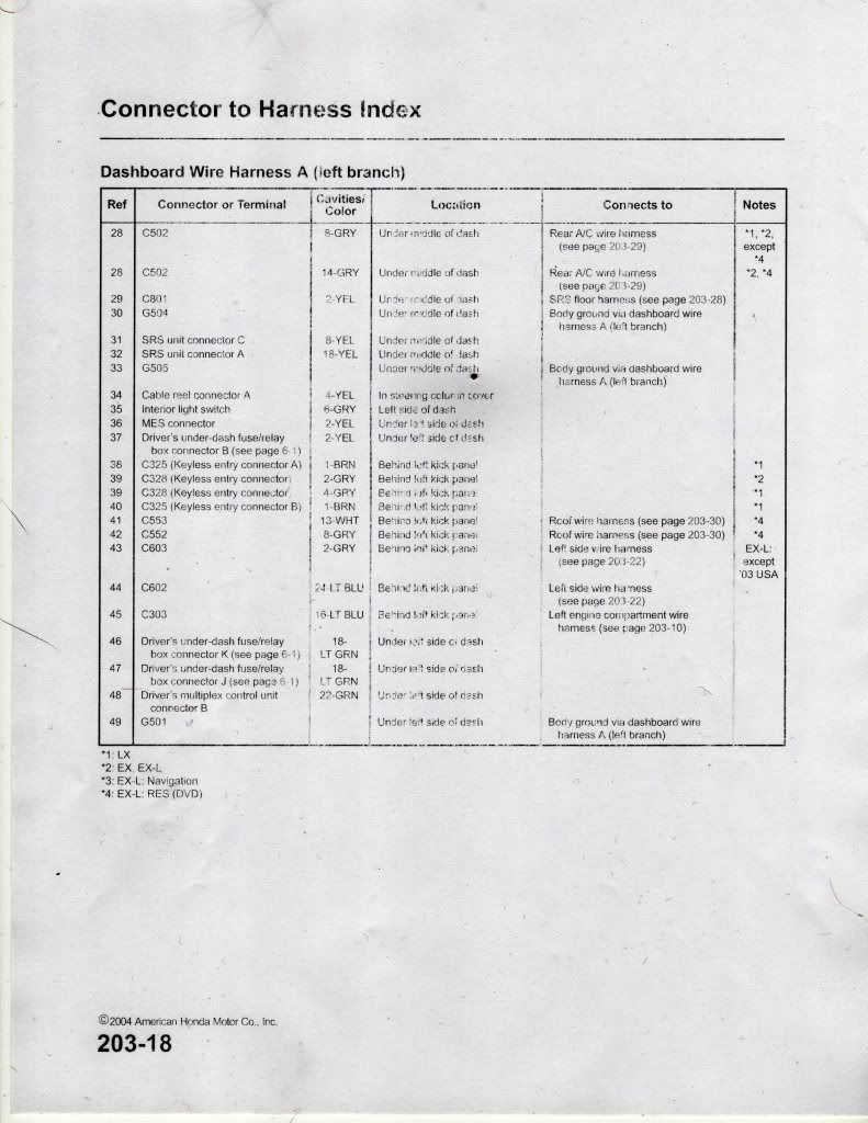

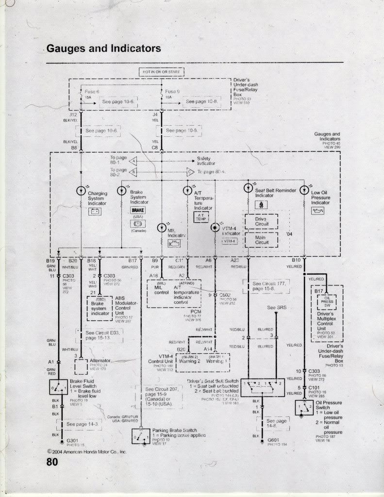

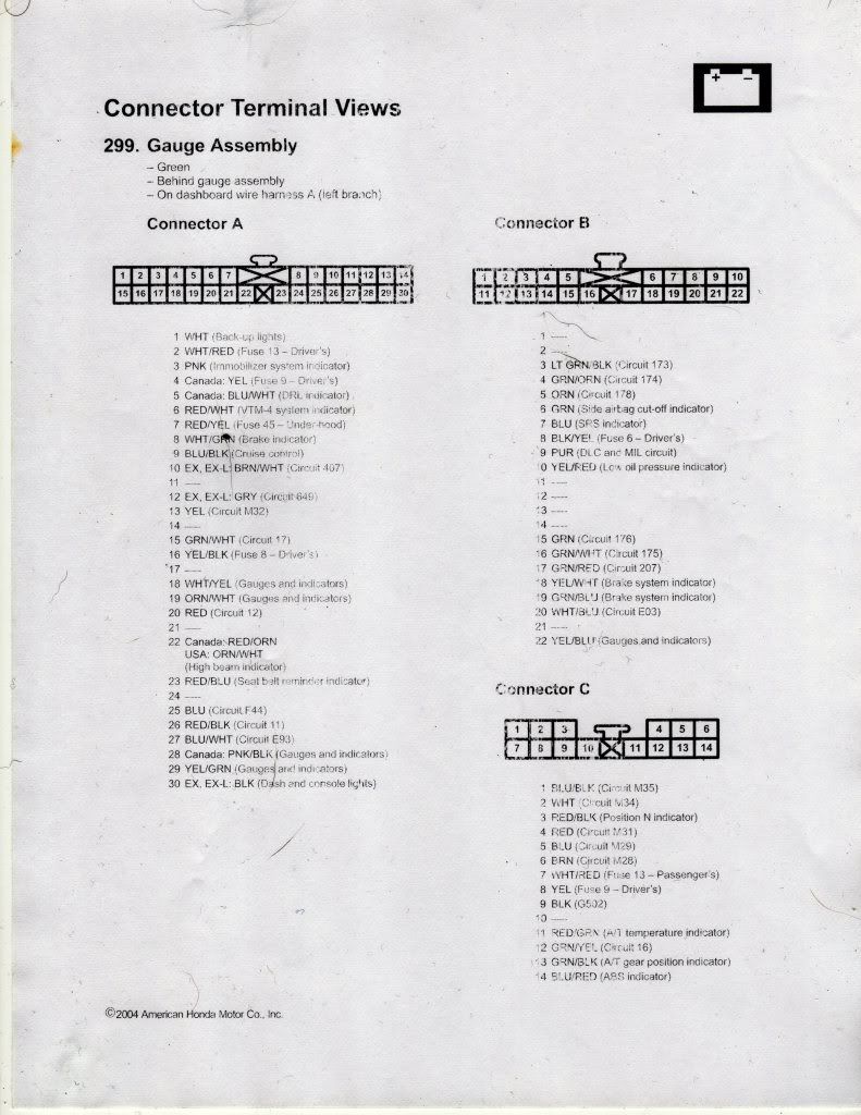

    i have all of the diagams. will clean up everyhting in pnotoshop and post here!!!!

    fruits of my labor, and i still need morrrrreeeee
    there are 3 other pages like this one. the first one. i need them as well. i shall get them this weekend.
