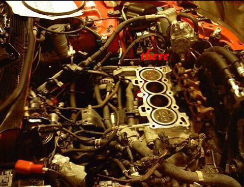

    i am about to do a minime on my delsol. i already have the d16z6 motor in my delsol and my motor has a very small knock to it so i am going to pull the motor and build a minime but i am wanting to know if there is a plug that i need to pull off the d15 block so the v-tec gets oil to it. i have had some people tell me that i have to take a plug off the block and some people told me i dont i just bolt the head on any info would help and be appreciated
    家nj-♠ ranj's Avatar
    883
    yeah there is
    in the pic
    what you can do is, when you get to this part, the thing that i pointed out, you can stick a screw (woodscrew) in and pull at the wood screw with some pliers and it should come out.
    i've been told vtec doesn't kick in w/o doing this.

    so all i do is put a screw in the and pull at it and it will come out

    yea i went and pulled the head off the d15 motor and i see what you are talking about but it already has a little hole in it for the oil to come thru does it need to be bigger or something
    家nj-♠ ranj's Avatar
    883
    yeah it needs all of the hole free for vtec to kick in properly,
    i read up on this alot b4 i had second thoughts about doing it b/c i have a b7 in my car, i'm just going to save up for LS swap.
    but yea that hole isn't big enough.

    the reason most of the minime's are slow is b/c they use the non vtec engine equiped IM or tranny, this makes a big diff.
    in ur case though ur using the tranny, head, and IM from the z6 engine so it should be about the same as b4.
    oh and the comp. is gonna be a bit higher so u probably wouldn't want to boost it too much.
