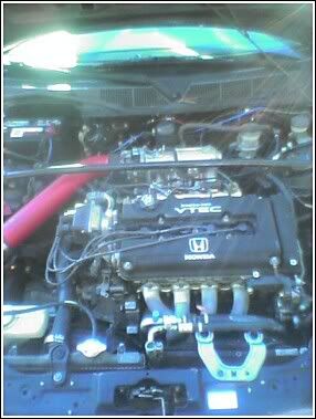

    Attached Thumbnails Attached Thumbnails -no-rice-jpg
    Jan 2005
    Columbus, Ga
    31,513
    this was me lookin at my motor in digust.
