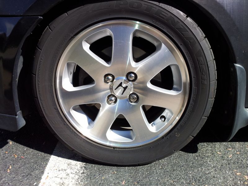

    Sounds like you want factory like clear coated wheels. Since you bought baller wheels i'm going to assume your ready to spend a little. My Si rims still have the factory clearcoat on them and look great for it's age. Does it look yellow, hmmm. Not that i can tell. Factory like clear from the manufacturer. From what i can tell it's clear that mixed with a hardener, the same stuff that clears your paint job from the factory. Factory paint is somewhat durable and it's cleared to give it that deep wet look when dry. I'd shoot for that. Why would want to repolish your wheels when you can just wash them whenever? What if you own multi cars, polishing your wheels on top of waxing your car is just time consuming. Screw that and go factory like...

    Owned these wheels for like a decade and they look decent to me. Look yellow, lol?

    If you decide to have them clearcoated, you need a UV resistant clear...not high temp or anything else, just UV resistant. Also remember that a sprayed on protectant (clear) will require further work to keep the perfectly smooth surface. The clear will need to be at minimum, compounded and smoothed down to reduce the texture, just like any paint application. As for the post above, those wheels are machined, big difference between polished and machined.
