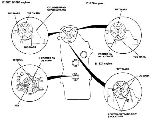

    HELPPPPPP PLEASEEEE. i gotta 90 honda hatch and its jumped time i dont kno much about em so could someone help me out and tell me how to set the timin back on track? thanks.

    The single mark on the Crank pulley is the TDC. On the Cam gear (depending on what one you have) the two marks directly across from eachother should be aligned with the head. The other single mark, MIGHT be slanted should face down. If you have the Gear that says UP, It should be facing up.

    took me 30 seconds and thats including the time to download it to photobucket and transfer the link.
