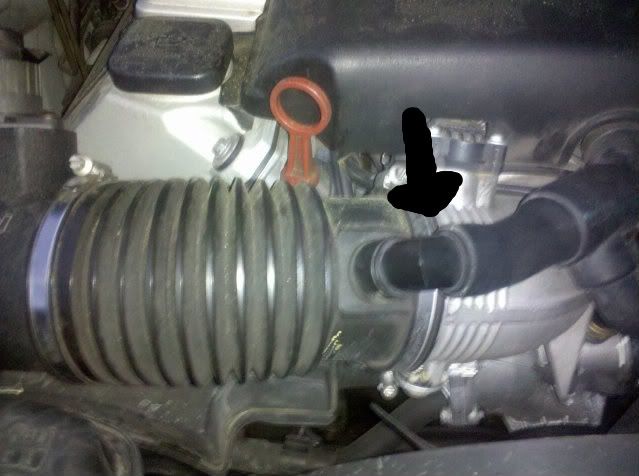

    okay for those wondering, no thats not a mushroom its an arrow, lol. I just looked over all the hoses and noticed that that hose was a little(meaning like 2mm out)pushed out,it was in, but not pushed in all the way. perhaps when changing out the radiator hose I nudged it out some.
    could that possibly cause those codes?
