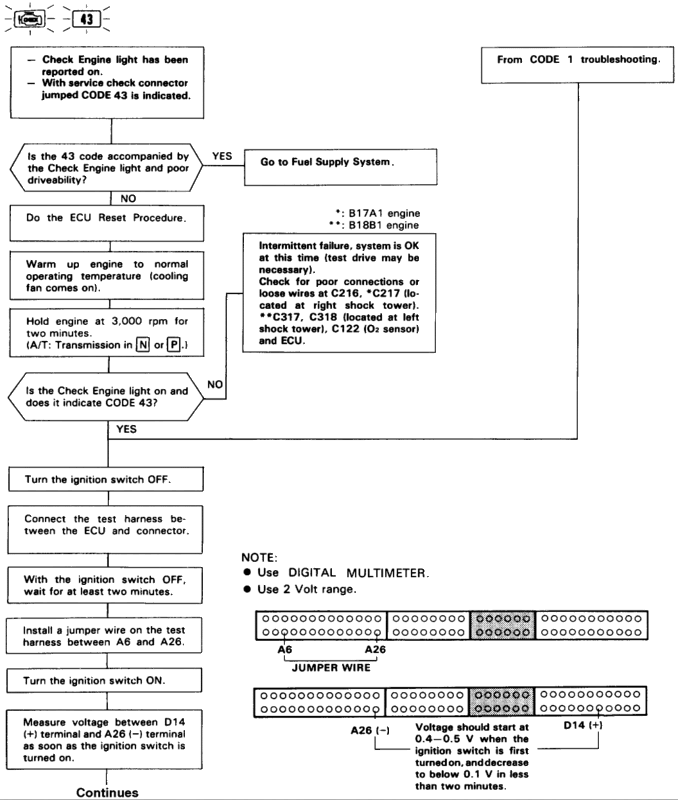

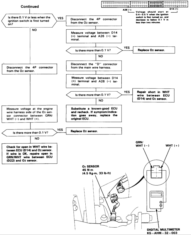

    problem solved

    not everyone can read the charts. but nice find.
    Do u have all data?
    Barefoot Motorsports
    May 2003
    jonesboro
    7,939
    U never know. He can learn to read it pay somebody who can and is trained to do it for him. (Hint hint cough cough) Yes I use alldatapro and shopkey5.
