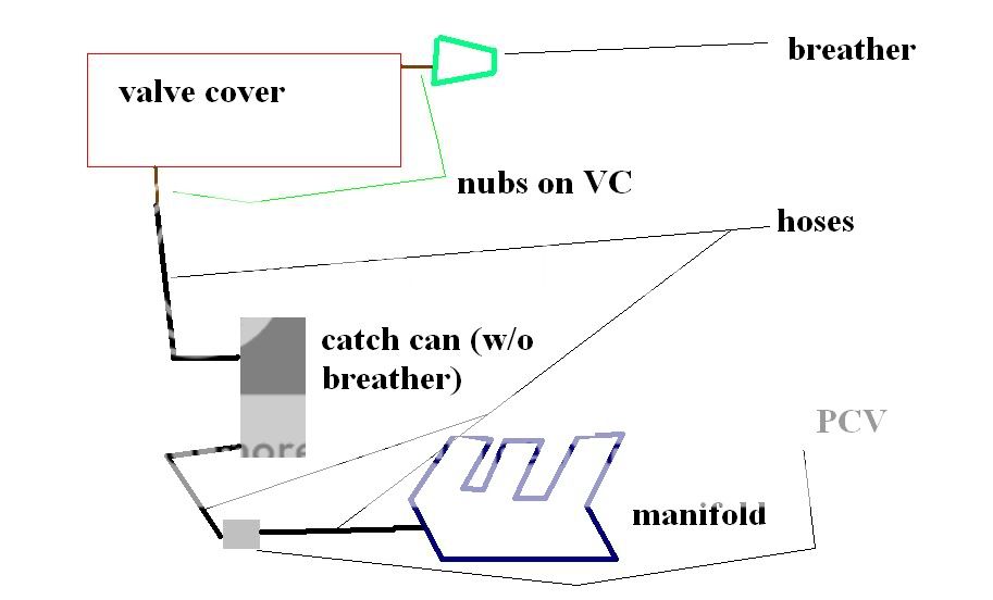

    IA Member Capiton23's Avatar
    Jul 2009
    lilburn
    95
    as i said, take it off and JB weld it shut. ill MS paint a diagram. 1 sec

    set it up like my drawing and it will be correct. this is best for N/a catch can apps. turbo you could possibly set it up slightly different, but for N/a this is best

    ok, i only have 1 nub on my VC ( D16Z6 ) so your saying the black elbow piece which is the PCV valve, take it and place where u have it on the drawing. How will this help ?
    your right hand man 97_luder's Avatar
    1,254
    you dont have to put the pvc there. leave it on your valve cover and run a line from the pcv to the catch can then to the IM

    oh, well i wasnt sure how your PCV was set up, mine has 2 nubs on the VC, ones a fresh air inlet and ones to the manifold. the pcv is in between two hoses going to the manifold. but if its attached to the VC leave it and install the catch can in line after it.

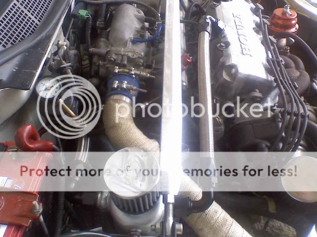

    ok so i know it comes off the VC. but were does the other side of the catch can go ? i cant really see it in the pic.
