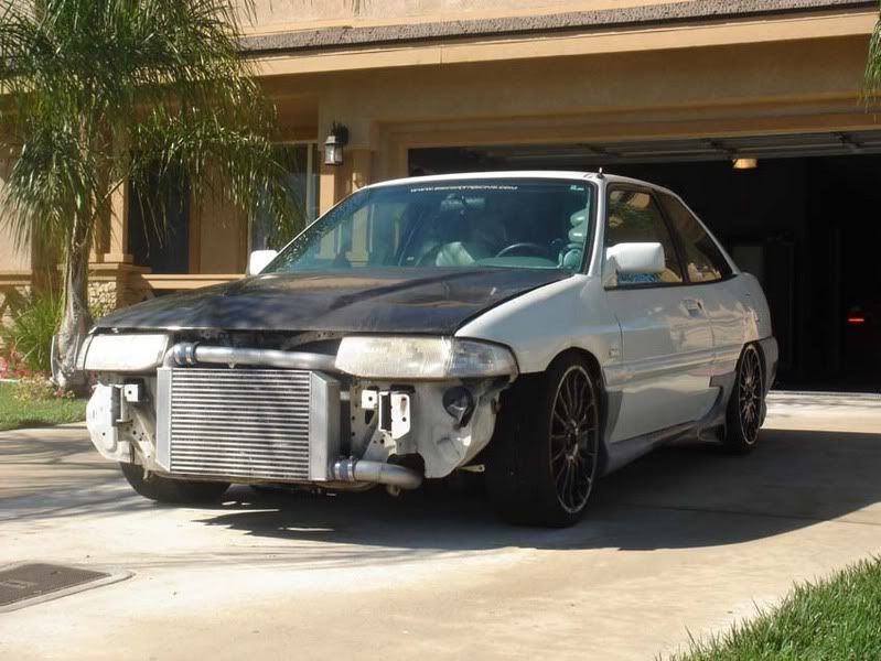

    hmm the reason i said Vacuum cause i put a few busted ass ones in a swapped escort i did. i changed MAP, injectors, plugs, wires, coils packs. u name it i changed it. it ended up been a vacuum line. i miss the xcort .. if i think of something else I did to mine ill post up if no one has helped u out all ready
    btw here a pic of my swapped escort
