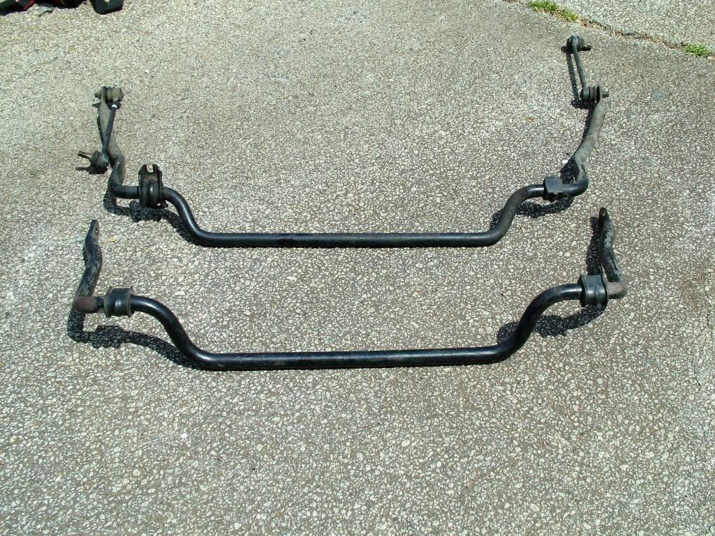

    This is a comparison of the rear sway bars:

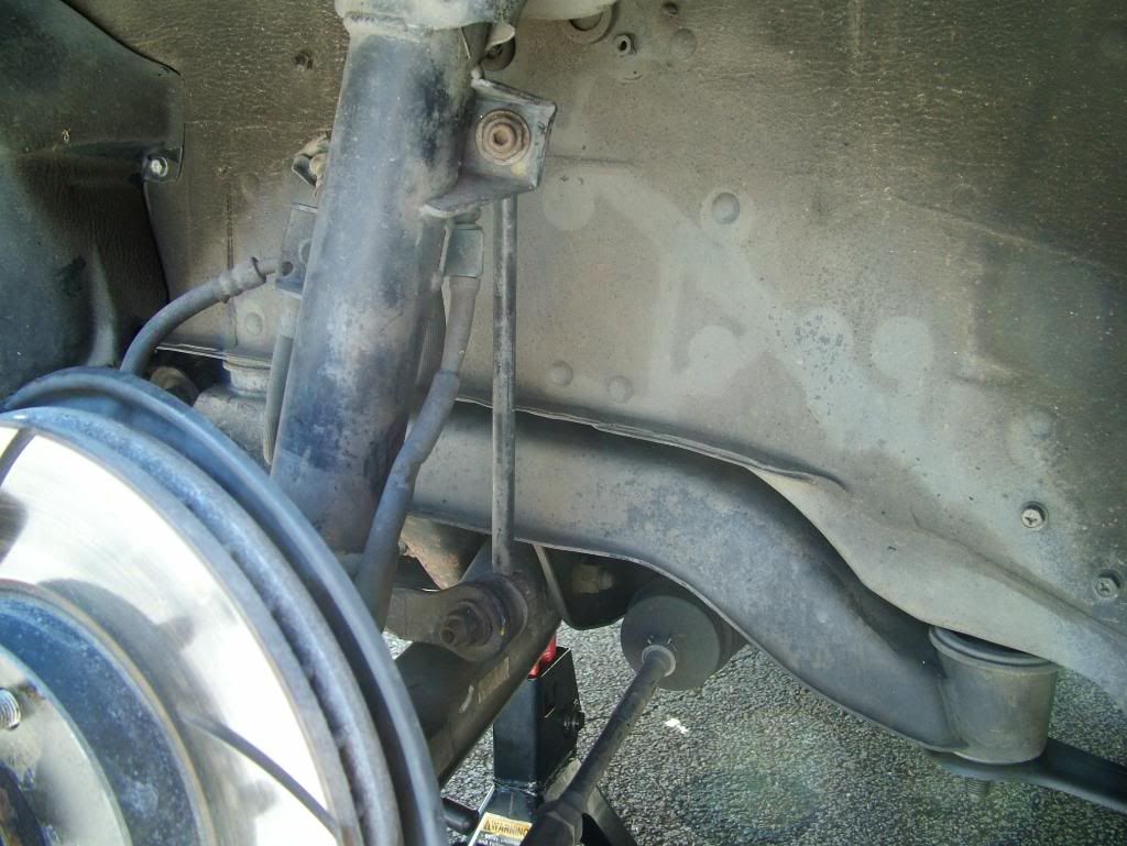

    Ok. First step is done. I got a 300zx z32 front sway bar and s13 endlinks to try and fit on my car and it works! Here are some pics of what I did. Next part is getting the front spindles and coilovers. Coilovers is the main part that is holding me back. I can't find a good set right now for a decent price.

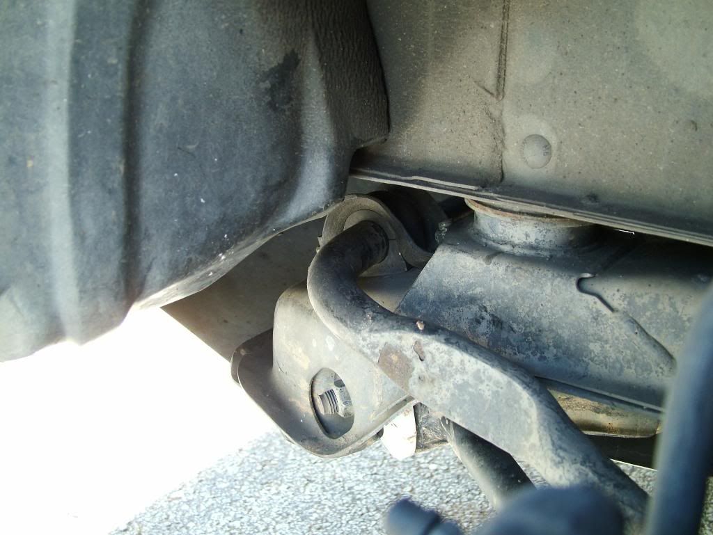

    Shows how the stock endlink mounts to the McPherson strut

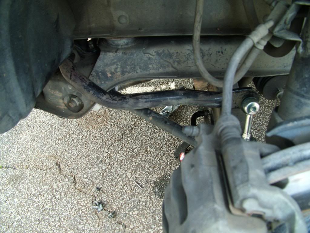

    How the sway bar mounts and how they flattened out a section

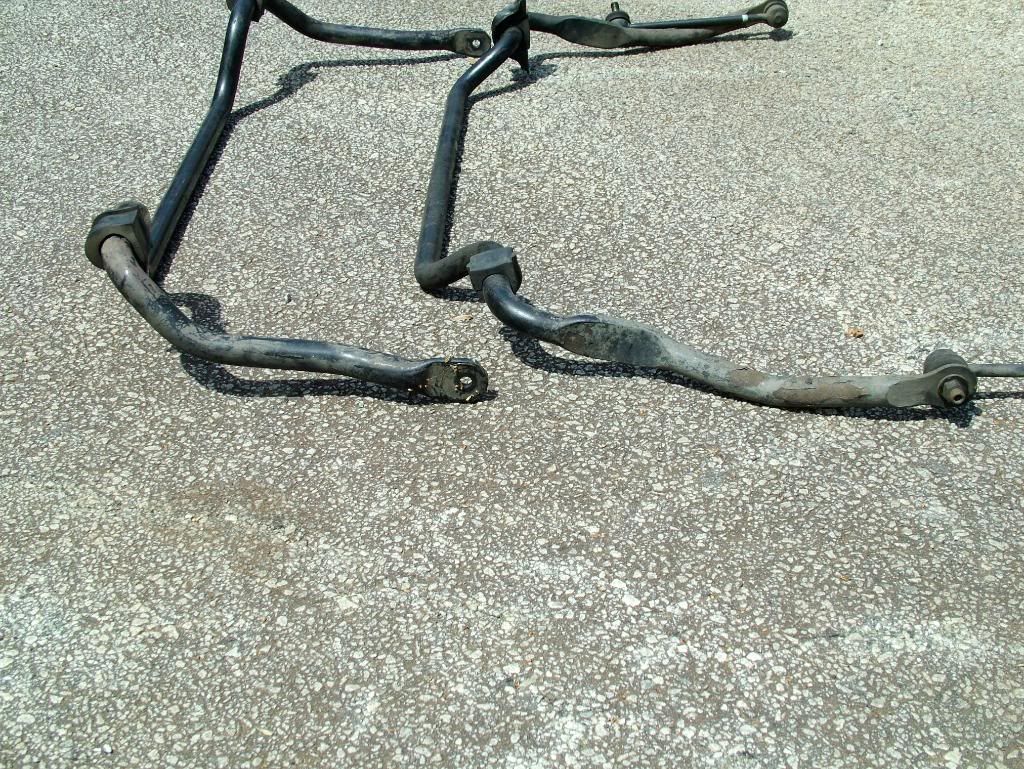

    Comparison of the sway bars. 300zx sway bar is in front. The arms are slightly shorter which is what I need.

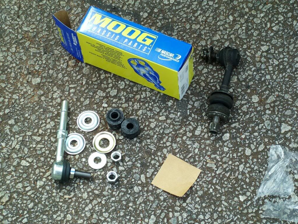

    Got new endlinks from Advanced

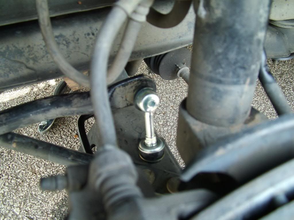

    Everything bolted up
    The stock sway bar sat above the subframe. I had to push the 300zx sway bar behind that for it to sit properly to get mounted.
    Should have the spindles some time this week and try them on a junk J30 to see if they fit.
