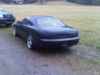

    okay i just got this sc400 on feb 23 and its not running, motor turns, starter is fine..
    also, prev. owner said the car would drive fine till it warmed up then cut off...
    no spark//i changed the coil pack, still nothing
    fuel to the rails
    fuel pump works
    plugs are wett
    all help is appreciated guys +++4lol
    and some random pics
    this car will run while in my hands
