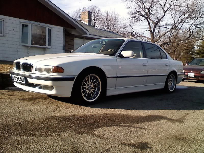

    More to tease you lol!
    Weekly Gwinnett/Junciton Meet
    9,765
    ^"Damn you, vicotry shall be mine"
