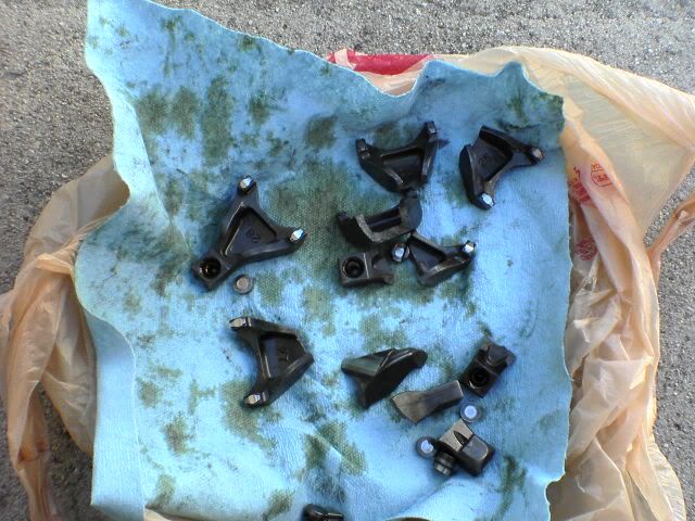

    Do not forget Rocker Arm Stoppers. I speak from experience. 70 bucks for a set can save u from spending thousands of dollars.
    Definitly the rocker arm stoppers. Saved my a** a couple of times. I wouldn't suggest the AEM for a smaller setup like what you want to do, plus the 550 inj, I would go with emanage ultimate which is about 1000.00 less than the EMS and will do as much as you need for tuning.

    this is why u get rocker arm stoppers
