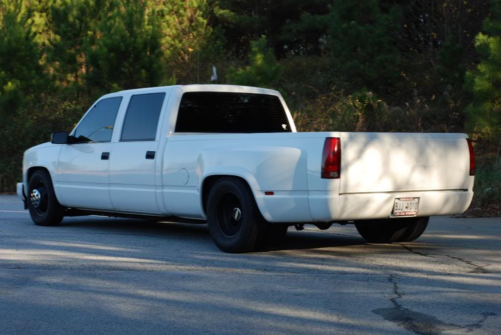

    leafs with flip kit and c-nocth on my tow rig.............. 7" drop
