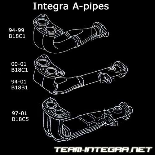

    Here's a pic that I stole from team-integra.
    If the catback is from a 00 and up GSR, then it'll fit your car.
    If it's from a 94-99 GSR, then you can go to any muffle shop and they'll modify it to fit your car no problem.
