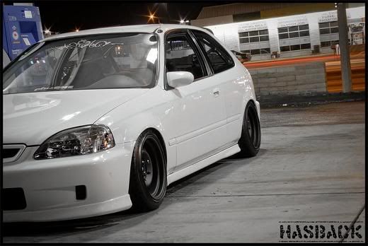

    does anyone know a place around metro atl that can rebarrel wheels? i want my steelies to look like this 15x8 +15off set

    Your steelies do not have a barrel seperate from the center. I don't think that you will be able to rebarrel them. Wheels like CCWs that bolt together can have the barrel replaced.
    Diamond Racing should have wheels priced cheaper than the work would cost.

    They are sliced with a bandsaw, waterjet, or CNC machine then widened with a "spacer". This is common practice in custom motorcycle building. I've called one of the largest wheel repair companies in Atlanta and they referred me to a shop in Texas that does it. This was for a aluminum wheel though.

    Widening is different from rebarreling.

    if you just widen the steelies, the offsets will not be what you are going for, youll just make the wheel stick farther inside the car, and not come outwards like you want. there are a couple sets for sale on hondatech right now.
