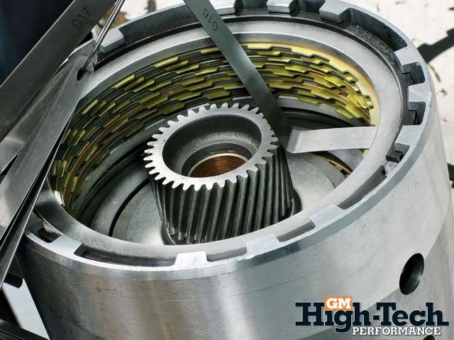

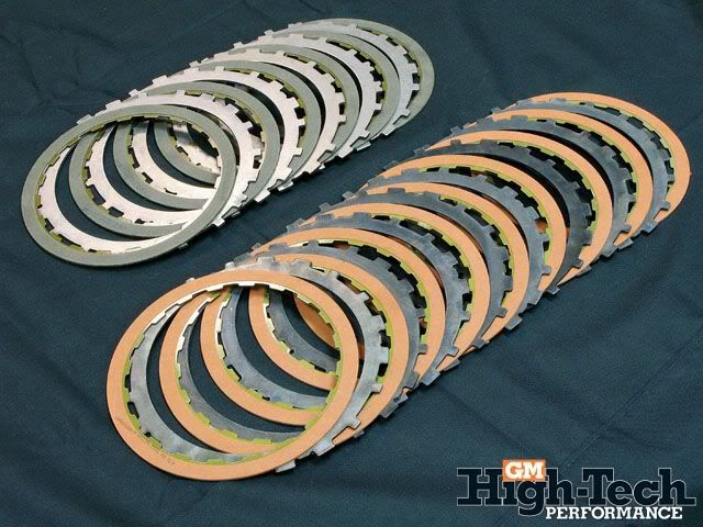

    inside the tranny there are a series of small clutch packs that look like this:
