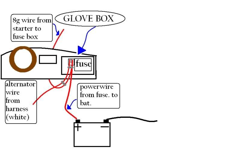

    am do a wire tuck and i need to know how to re0wire the two cables in the fuse box on of them goes to the posivte on the battery does any one know how to?

    i drew this up right quick. hope it helps..

    thanks it hepled
