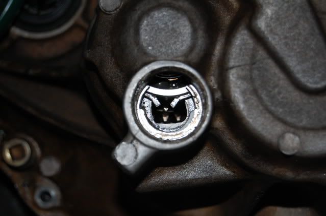

    alright i have this 5sp dseries hydro tranny, and i need to split it open but i have no idea how to remove this clip..
    plz help

    ringclip pliers, it spreads it apart as you pull the housing off
    aye bro .:Stirfry:.'s Avatar
    4,344
    oh so just spread it and pull it at the same time?

    Yep spread and pull. LOL. Its usually spread and push right??:boobies:

    yea i knoe right!.. so thats where i was messin up at.

    Most of the time, if you spread it open and wiggle the box, the stack will drop enough to keep it open. Then you can use both your hands to focus on getting the case off.

    dont forget the ball locks
    good luck getting the clip back in place..... it can be frustrating

    yeah... its a serious headache when doing alone
