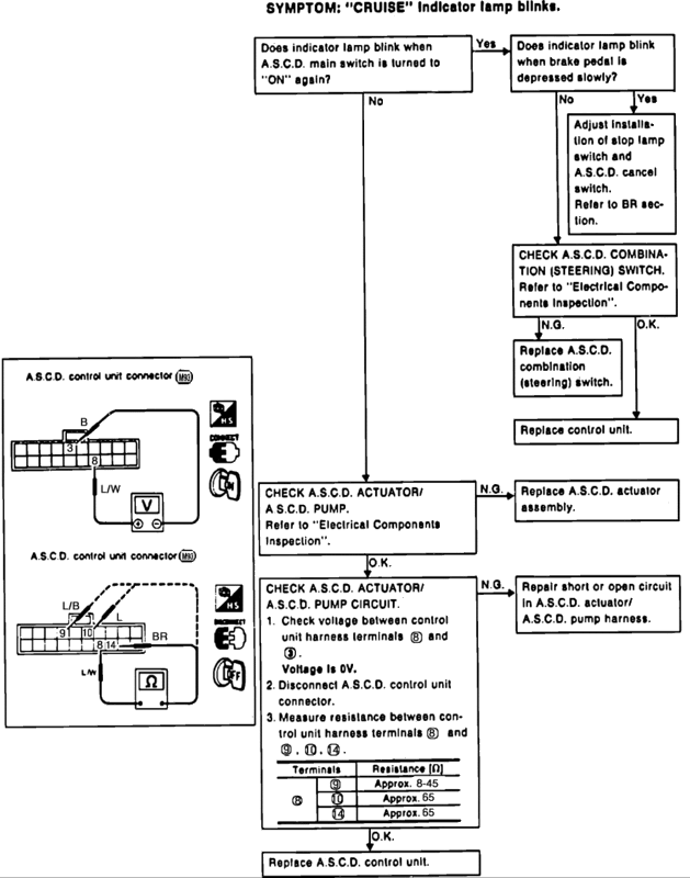

    So I just bought a 1992 300zx and when you turn the master cruise control on, the cruise control light flashes. Its the light that turns on when ur car is actually in cruse mode, not the master cruse control light. I think a fuse or maybe a relay is out. What do yall think?

    Great suggestion...
