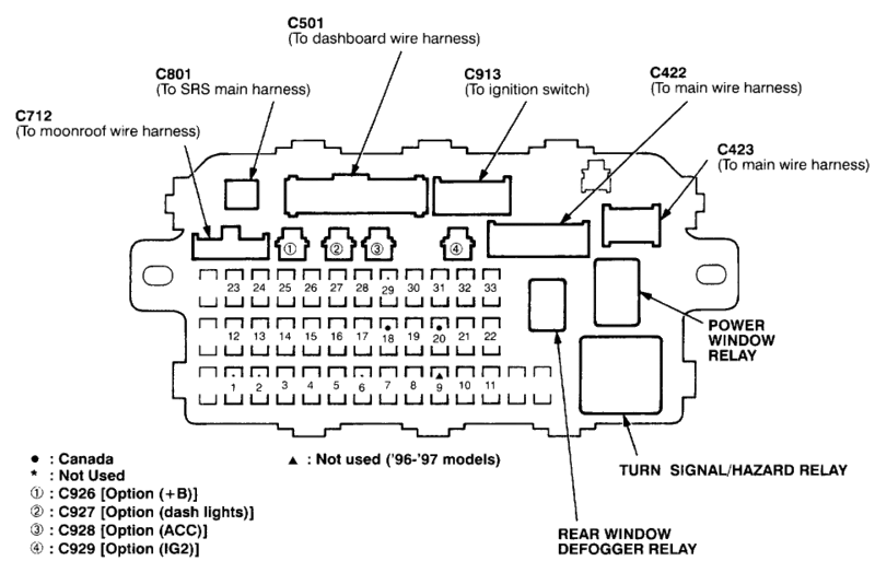

    check fuse 25 under dash
    Aug 2009
    2,380
    Quote Originally Posted by Barefoot View Post
    integra don't have a fuse 25 underdash.
    the only number that i can see is the amp number. (Ex:7.5A- Interior light)
    Barefoot Motorsports
    May 2003
    jonesboro
    7,939
    Quote Originally Posted by Austin? View Post
    there should be with a 7.5a fuse in it.
    The Slums of GA
    1,618
    that must be diagram for someother car.
    i checked and on the integra the highest number is fuse 23
    Where Am I
    4,403
    Quote Originally Posted by wanggsticky View Post
    u sure did u see the other row, there should be 3 rows of fuses I'm petty sure there is at least 30..... Is the car running/charging good, check the batter with a volt meter when its running.... Because ur speed sensor is on same fuse as the altenator...
