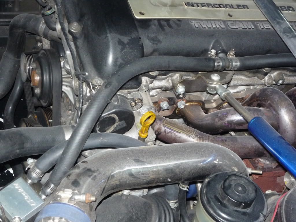

    buy me some STP octane booster whatever210's Avatar
    MCD
    1,692
    here what my set up looks like on my sr20

    Twan Jdm94Coupe's Avatar
    Fairburn
    4,051
    Quote Originally Posted by whatever210 View Post
    looks like you need some easy off oven cleaner and a bottle of simple green, lol
    MCD
    1,692
    fuckin christ. i said this is what my set up looks like not a pic of my fucking car.
