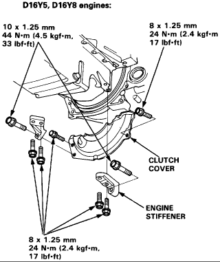

    Can anybody tell me how the dust plate for y7 block goes on? Do I need to take off tranny or you think i can get it on without taking off tranny? Also does it go on the outside of clutch assembly or the other side? Plz somebody help me!!!

    u can put it on without taking off the tranny. just place it on it there pretty much.
