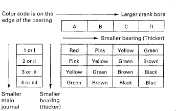

    can u see any colors on the bearings still.

    Quote Originally Posted by Barefoot View Post
    nah they are shiney,i know they were replaced and still look pretty good.

    or u can manually size them which a bitch but will be the most accurate. it will take into account for wear over time.

    Quote Originally Posted by THEONE View Post
    that is interesting there^^^ but i have no idea what i means haha.
    all i have are numbers no colors im guessing they are standard size since they are stamped std. man when i was buildin chevy motors and olds motors this was much mor simple they would have the size stamped right on the bearing.hondas piss me off lol
    if they are oem they have a color (same as the same) on them if there aftermarket only god knows.
