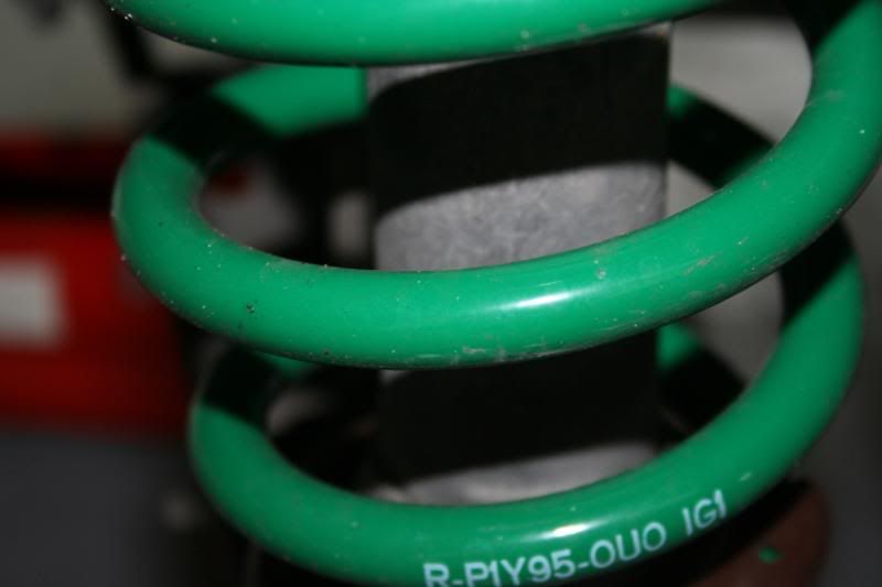

    Shows the spring rates, if it has them, check them. I am sure they didn't install the fronts on the back or anything you'd know VERY easily.

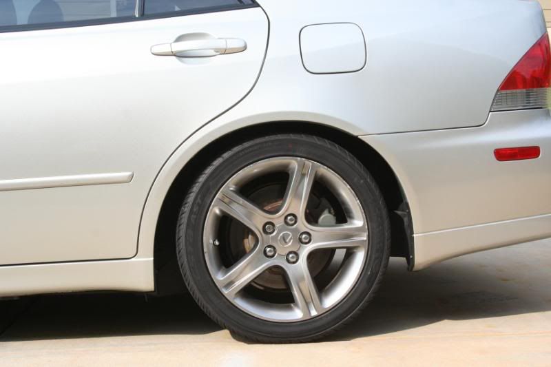

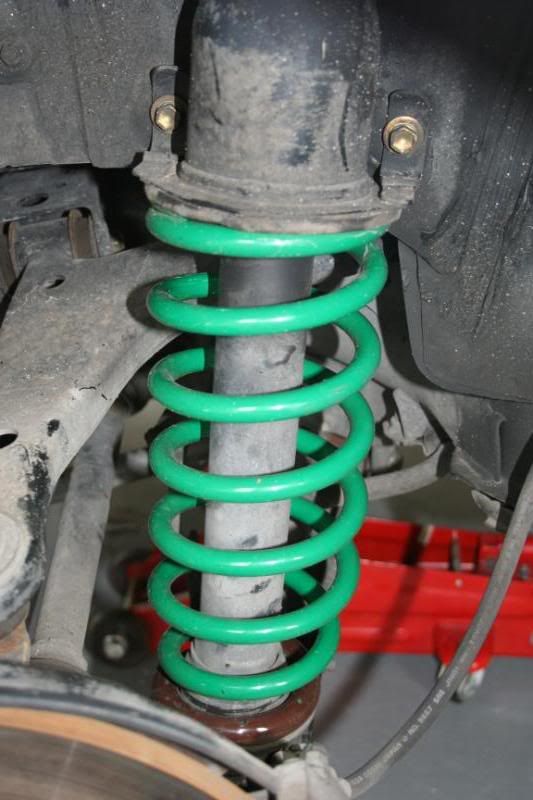

    Ok pics are up Look at the side view pics of the gap between the tire and the wheel well. The gap difference is half an inch. The lower side looks to be the right height for the Tein s tech drop. The other side look jacked up!?!?!
    66
    Yeah, like Jesse said I think the higher side is the side that's messed up. I don't see anything wrong from the pics how the springs are sitting. You have all the same size tires right? lol.
    Do you know which pic of what side is what? Like which pic of the spring is right and left?

    LOL Tires are all the same.......Would the bumpstops being cut make any difference in ride height?. I just think something wasnt done right.

    You can tell by the position of the calipers.
    Sep 2009
    NW GA
    Pass.
    Driver

    Is the top of the spring on the driver side sitting right?
    Sep 2009
    NW GA
    Can't tell from the pics, but do both springs have the same thing written on them? If not then that could be the problem.
