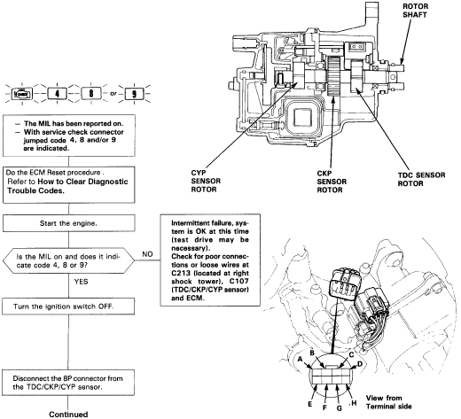

    ok i need help. i just put a b series swap into a 92 eg hatch. every code has been fixed,but this is the only code it is throwin which is code 8. i have replaced the distubtor,new spark plugs and wires, did the timin again,,and again,used 3 different ecu. this is the first time i have ever had this promblem, i have done plenty of swaps

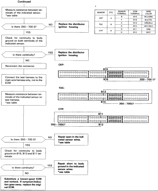

    Quote Originally Posted by eckok24 View Post
    i did what u posted barefoot but nottin different i disconeccted the battery and still throwin a code 8
    u did the whole flow chart
    362
    i check for power between the ecu and the distubtor it gettin power. i check b14 and b13. i amd just about to bang my head against to the wall. the next step might be the hardness. which i dout is wrong. i reset the computer ,no check engine light. i then turn the car on which takes a few seconds more then i think it should. it laggs when u crank it. and code 8 is the only code

    what ohms reading did u get for b15,16 b13,14 and b11,12
    anyoner else
    man please u didnt even complete the chart that has the answer on it. it just take a lil work. stop wanting the answer flat out handed to u. do the work learn something and you will get your answer.
