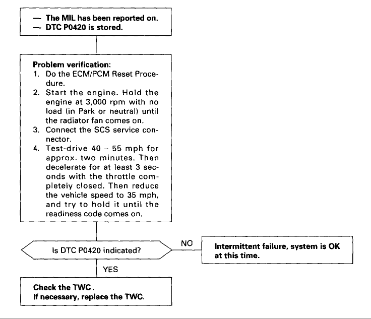

    if there are not any other codes listing and no exhaust leaks do this.

    so u have 2 codes p0420 and p0421
