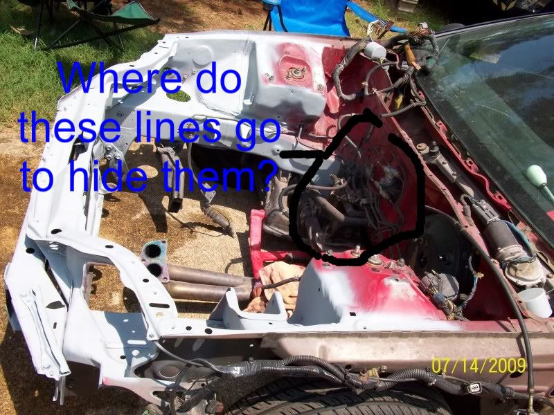

    i need to know where to put the lines that are on the fire wall to do a wire tuck like hide them so you dnt see them where do yall usually put them at?

    am talking about these lines?
    PURP-a-trader PURP's Avatar
    13,880
    those are brake lines... those stay unless you have a flaring tool and more lines to relocate. This is how mine is... But it's a full custom brake line tuck

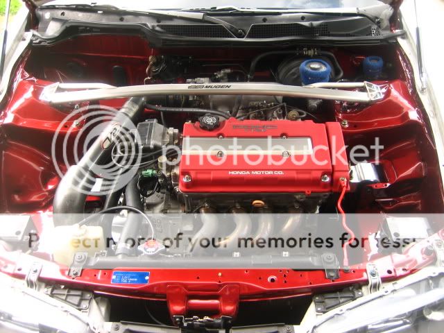

    Here's one me and a couple of friends did. The way we did it, we didn't drill holes or anything. We took out the entire blower/heater core. I don't drive the car in the rain so i didn't care. We ran the wires through that hole and no need for stretch or anything. The headlight harnesses are ran through the fenders. The brakes line are a bit more complicated then we thought so we just removed the abs and left it at that. I don't recommend messing with the brake line unless u know what u are doing. If you still want to do it, make sure you get a metric flaring tool and NOT stardard size. The bay isn't done yet either just close to it lol.

    not nick picking... but the way you ran the wires would be able to be seen. You drill the holes to get the harness lower and out of sight. I also, removed both boxes from under the dash and made block off plates. But since the heater core hole sits on a flat part of the firewall, you're able to see the lines. Just preference I guess. But I like all mine hidden. Bay looks good. Should have gotten rid of the fuel set-up while you were at it and also should have flipped the booster to hide the vaccumm(sp) hose from the booster to the manifold. Also, take the ground wire and mount it on the back of the valve cover and mount to the side of the strut tower. Just some helpful ideas. Again, the bay looks good

    Yeh, i can agree with you that it can be seen but just barely. Thanks for the ideas lol I'll be sure to do that when we start working on this thing again. It got way more work to do. Also, thanks for the compliment, same goes for u too
