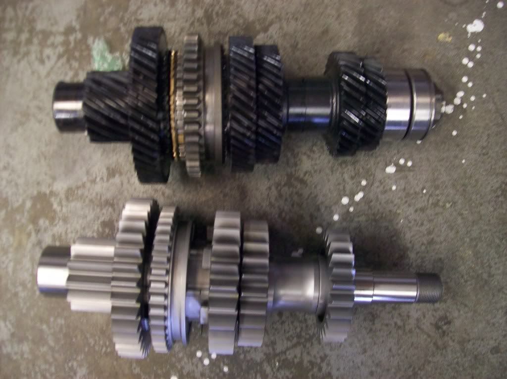

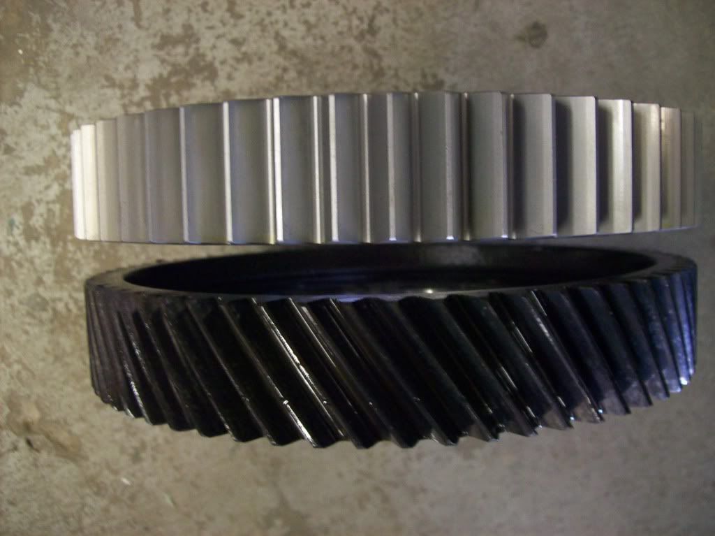

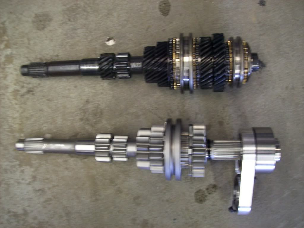

    here's a ppg set we just finished up on a h-trans...
    PPG Dogbox gear set - Transmission built inhouse - Dark colored gears are the original heat treated gears
    The ring gears side by side:
    The Mainshafts with the handcuff side by side:
    The countershafts:

    PPG will be coming out with a B-series syncro box soon if you are too concerned with it being streetable and hold up to the power.
    But for the record, that same gear set in an Integra (Palo) and civic (Miller) both with 8s.
