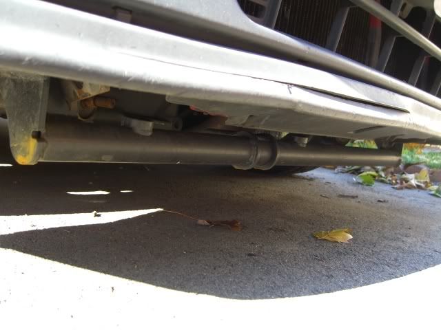

    can i put on an after market header because it seem to be really tight??? anyone have the same swap with problem like this??? i cant side my finger threw it...

    you gotta knotch it out or buy an aftermarket crossmember...
    here is the innovative mounts x-member

    do i really need that part down there??? is it just bolted on or i gotta hit it out???

    yea, you need it, and its bolted on. here is a link to the innovative one...

    those things are pretty expensive too uhh...

    yea, just cut yours and ride out bro. I've done it many times...

    lol...is it safe...

    if i go boost will i need to replace the crossmember???

    if you can afford to go boost, then you can afford the proper x-member. Is it safe ? I haven't seen anyone with any issues after cutting one, and I cut the shit out of mine. But I'm sure its not as safe as before....

    u can knotch the frame now or just buy a aftermarket that will support your needs. like punk said if u can afford to go boost u can afford the right parts.

    lol yea thats true but the love for power just seem to be better to paid for then a metal bar thats in my way...ohh and most of my turbo parts kinda got it for free or real cheap...i quess i'll start looking for a after market crossmember...thanks for the good info guys
