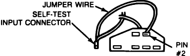

    3. ACTIVATE the self test by grounding the STI connector.
    Jumper Wire Installed Between Pin #2 And Self Test Input (STI)
