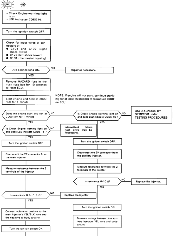

    i have a code flashing 16 times on my ecu in my 91 civic dx.it runs fine but gets kinda ify past 1/2 throttle like it bogs and goes or even causes the car to jerk a little if you accelerate to quickly.
    i dont really care about the performance part my question is will this cause me to fail emissions?the car does not seem to run rich i think the code is a injector issue.not sure though any ideas?
