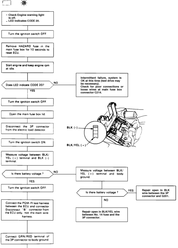

    ok so im throwing a few codes i may need help with
    ok im throwing 14 IACV
    16 fuel injector
    and 20 electronic load detector
    ok so my ecu is in limp mode not letting me go past 3500 rpms
    i replaced my iacv and i believe the code is still being thrown
    the fuel injectors were fine in the car they came out of the day before i put it in my car and i dont know where the eld is so can someone help me out on wat to do? reps for good help

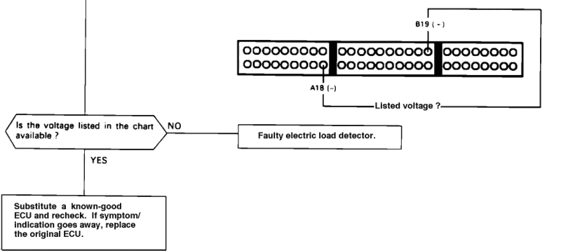

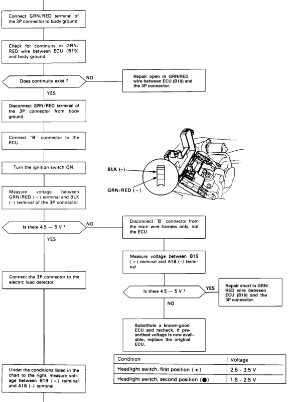

    trouble shoot code 20 and i bet the rest will fix its self.
