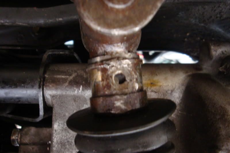

    ok so i got the axles in and everything but im only having problem with the BITCHpin. that shits a fucking bitch LITERALLY!!! i drowned that bitch in wd40 and pbblaster and still nothing!!! i got the 8mm punch and im beating the shit out of it, and nothing!! here's a pic i hit it so much it looks welded in. lmfao.

    u need a roll pin punch. lol needed at this point looks like u fucked that 1 pretty good.
    2,964
    what do we get if we come over and knock that pin out?? and your using a 8mm to knock it out? I usually use a 3/16 to knock that thing out and it goes in easy and comes out like a charm ..
