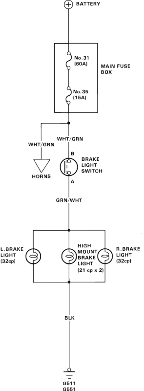

    simple system should be an easy find. start with this 1 the other 2 are on different systems. looking at the diagram they are way more in depth.
