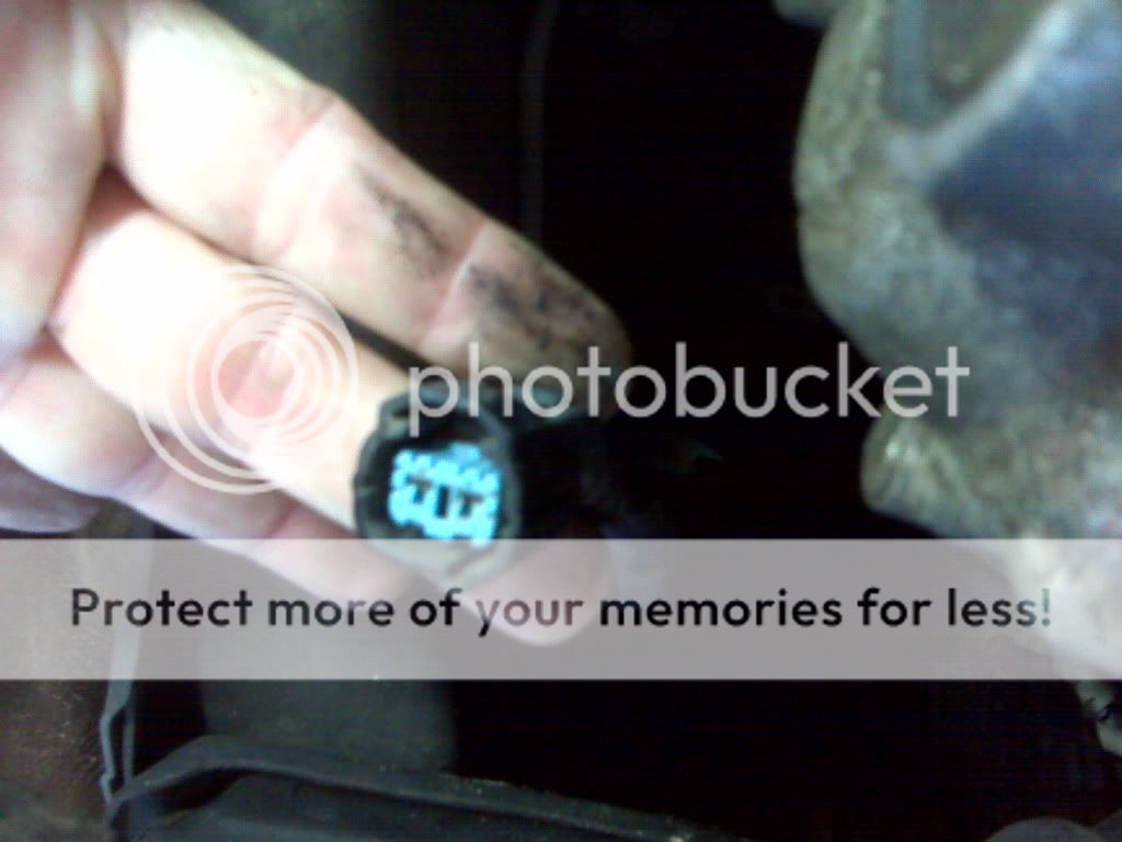

    This one is behind the motor and trans, I think its a O2 sensor connector but not sure

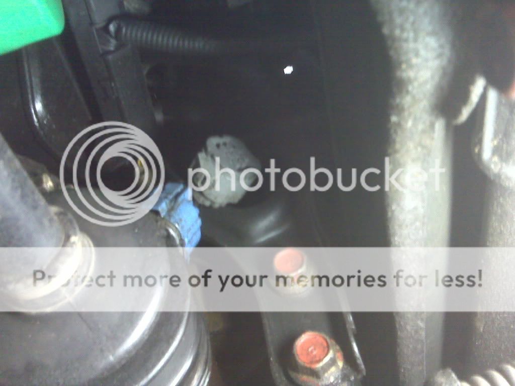

    This one is under the intake manifold area right behind the head

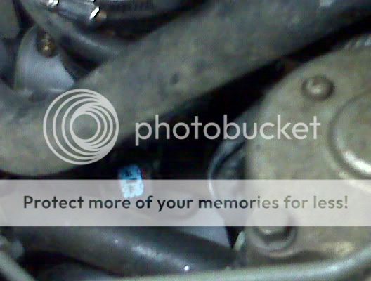

    This one is come off of the wiring harness on the passenger side

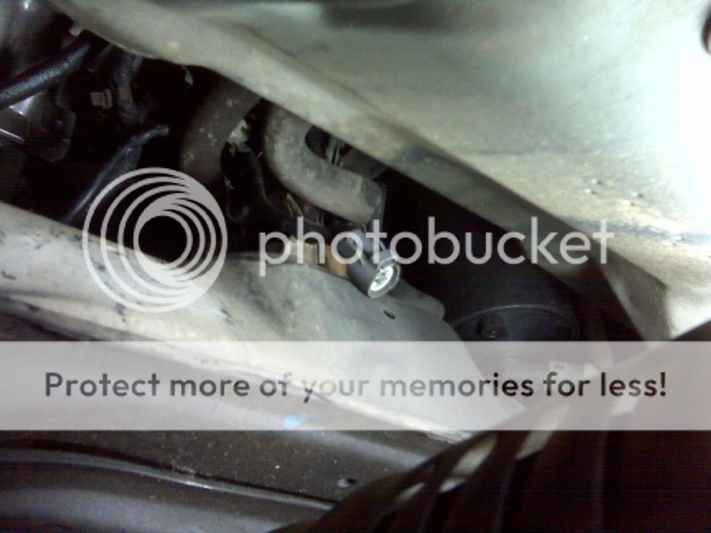

    If I remember correct, this one is right next to the driver side axle

    none of those are 02, and seeing as there are many connectors alike, without seeing the wire colors it is hard to tell... but seeing as its an obd2 harness, the second plug is either evap solenoid or IAT.

    With the second and third picture showing the same connector I'm kind of confused with those

    The first one may be, Power steering pressure, IACV, knock(depending on how many wires) etcetc...

    Looks like the last one might be a speed sensor plug, I'm probably wrong though.

    pic one=2 wire round grey plug. gotta love honda for using same plug all over the engine bay. run continuity test to be sure what wire it is. don't just go plugging it in. if it's the wrong one you could burn the ecu and or iat sensor. in that area it could be:
    iat (unless it's ek)
    iacv
    pwr steering
    pic 2, black squareish plug 2 wire could be what james said. if it's an ek.
    pic 3, gray plug w/ dead end connector is a distribution block. more than likely your distribution for iacv, injectors, etc.
