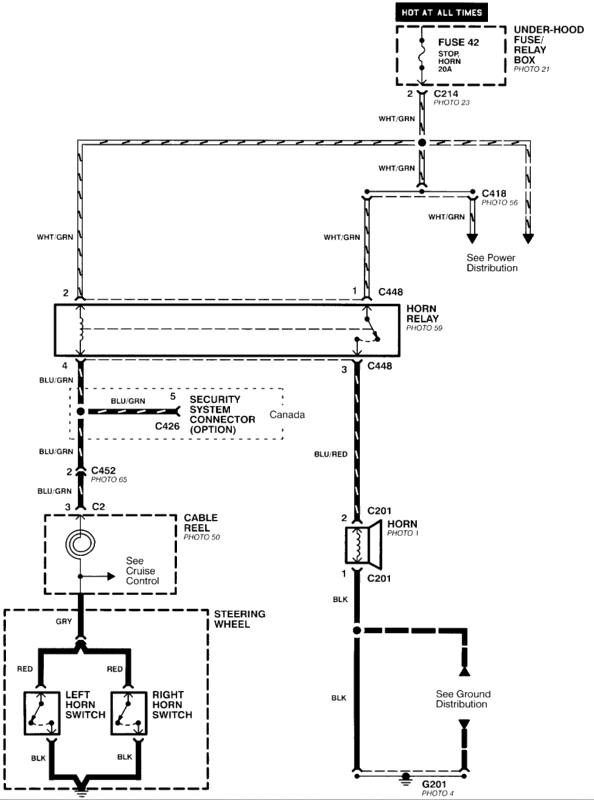

    Well I've had this problem for sometime now, and just got to wondering whats wrong with this damn horn of mines. I tried putting a 20a fuse in (under the hood fuse box) and it still doesn't work. Put in a 96 integra air bag, and it still doesn't work. The horn button isn't broken, the horn does get power (used a test light) and I even replaced the horn. What do you guys think the problem is?

    is the horn gettin ground contact?

    if the horn is getting power u and no noise bad horn or a ground.

    yeah i was thinking it was a bad ground problem, any idea of where the ground is?

    There should be two wires hooked to the horn, the one with no power is ground. Im not sure because im not lookin at it in person.

    to make it easy on u this is the diagram if u cant figure it out from this your going to need professional help.

    lol its all good man my horn dont work either,when you hit the horn button can here a clicking noise from the dash?
    That's the relay

    Being able to hear it means the relay is functioning properly right?

    Yeah when I click it I hear a clicking noise, AHHH its aggravating when stupid people don't know how to drive and you just dont have a horn...

    Hearing the relay means the horn switch is working and there is power to the relay. Then you must check past that.

    clock spring could be messed up also.

    alright i'll have an update as soon as i re-replace the steering wheel
