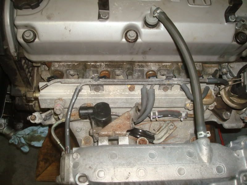

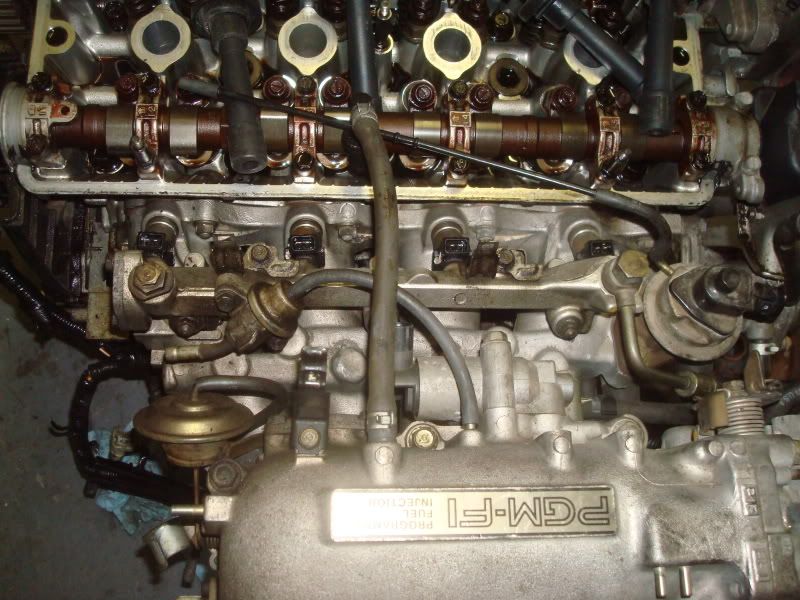

    LAWRENCEVILLE
    10,211
    the rails do not look like they will interchange! pics comeing
    Hella stock member!
    LAWRENCEVILLE
    10,211
    the f22 rail bolts to the manafold on the top of the rail!
    the h23 rail bolts to the manafold on the bottom of the rail
    Hella stock member!
    Super H8ter Starrfire's Avatar
    2,009
    They will not interchange, I know first hand. You need f22a1 stuff and then it would bolt up. Not sure on the f22b1 head, but some of the f22a's I've seen have the IAB manifolds on them.
