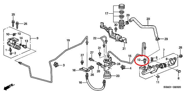

    long story short, the 03 cl type S master cylinder has an extra fitting that goes in it before the clutch hydraulics.
    apparently there was a screw up in honda's database and the fitting i need is next to impossible to find.
    what are the differences? i mean i can bend the clutch hardlines to make it work if i have to
    the part circled in red is what im referring to.

    I believe it may be for the quick disconnect part, or atleast that what it is like on mine.... you shoulda just went to autozone, I think they come with that fitting in it already...
