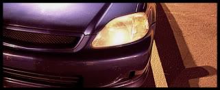

    Newnan
    11,007
    wetsand with 1200 until all is evenly sanded.
    buff with orbital and rubbing compound.. took me an hour.
    before:
    after:

    looking at that pic makes me want to resand with 2000 then buff.. too many scratches.
    def sand with 1500+ grit. 1200 isnt fine enough..
