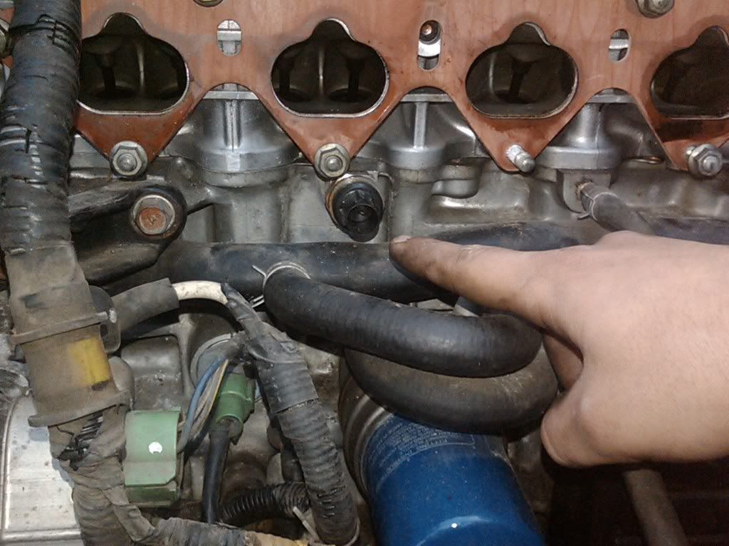

    Ok so im swapping a 93 b17a1 GSR swap onto my 90 DA integra. As you may know, the b17a1 swap is obd-1 and the 90 DA that im dropping the swap into comes in obd-0. So of course the engine harness is going to have different plugs.
    So heres where im stuck. I planned to basically use the obd-0 engine harness off of the LS and convert the obd-1 b17a1 swap into a obd-0 motor. I intended that so that my swap could run fine and not have any check engine lights. I knew that i would have to change up/exempt something so that i could make this work. So heres where i ask from you guyz help!!
    So i have come across one sensor on the back of the b17a1 block that my obd-0 harness doesnt have the clip to. I lost the obd-1 harness so i dont have a refference to use. And heres that plug:
    I heard that this is a knock sensor but then again i heard that only 0bd-2 and up vtec motorz have knock sensors. Not obd-1 and down. So whats the real deal here? I heard that this sensor can be straight wired to the ECU (that is if infact this is a knock sensor) or what can i do?

    knock
    12,599
    I'm guessing KS.
    9,284
    KS.

    ks

    knock

    How can I wire diz up? Can anyone give me a link or tell me which pin I have to wire it to! Remember I have obdo wiring so plz help me out ppl!!!

    If youre keeping the car obd0 then you dont need to worry about it at all. Just take it out and sell it.

    well i found out how to wire this knock sensor after all. it goes in b19. yea maybe it doesnt need it since its obd0 but i feel better if i know that i have it wired! and im also planning to run a 0bd1 p61 ecu so i think its going to ask for the ks. either way i got it so thanx to everyone!!! reps!!!
