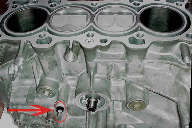

    Can someone give me a hand and tell me what this is, and where it goes please..

    oil pressure sensor

    oil pressure sensor
    dont plug it up car dont run.
    Barefoot Motorsports
    May 2003
    jonesboro
    7,939
    Quote Originally Posted by no mo hondas
    Quote Originally Posted by SUBY_RUE
    So your saying its not needed?, .
    if u dont plug the sensor up your car still not start.

    So your saying its not needed?, I swaped a b16a into my 92 hatch... I'm trying to finish up the wireing today...

    it will work dont listen to this dumbass but it wuld be good to plug it up. It will still work without
    u are a tard and have no clue whats going.
    J.R
    Down South
    803
    its got 2 be there 4 sum reason just plug it up

    I pluged it up and still no vtec, i have tested the solenoid, it works... the only thing i have not tried is testing the voltage yet. there are no dents in the oil pan, the vss is working (my cluster is working)... I am all out of ideas....

    The car runs with it pluged in and unpluged... just so you know...
    then u got more problems than no vtec.

    All im getting is code 21 (vtec spool solenoid)

    Now im getting a code 41 as well (primary o2 heater) i replaced the o2 and cel is still on...

    Any ideas people? I need to get the car running right....
