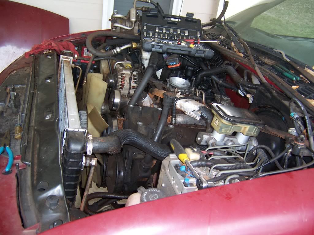

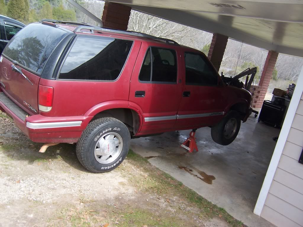

    My TBI 4.3 in the old 87 I had ran for 3 years with a blown head gasket but it was running out the exhaust. Had to add water every 4-5 days or so but ran great.
    BMW 750iL
    3,502
    I need to stop being lazy and get done lol
