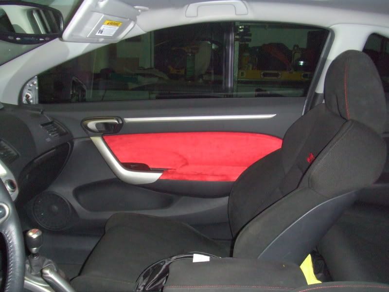

    I'm planning to put some suede on door panel, glove box, center consol, etc.
    Wonder what material use for stick on the panel? super glue?

    you'll need to use fabric/appolstery (sp?) glue.
    don't ghetto it up - super glue = big no no.

    When we did my buddies door panels on his Toyota we used a product from Am Chem called "Super Stuck Up" it worked great.

    if you want to do it the RIGHT way, you would actually glue the suede onto a thin white peice of fabric (forgot what it's called) and then glue the white onto whatever surface... then smooth it out , let it dry , etc.
    but i imagine you could probably skip that step. just make sure you use either a spray glue or a brush on glue. don't "kingergarten elmers glue streak" it up haha

    Michael's (the craft store) or any fabric store... maybe even hobby lobby?

    Yeah we got ours in the Crafts section at Wal Mart.

    i used this 4 dollar bottle of spray adhesive in the paint section from walmart
    it works well
    get some goof off too, you're sure to spray some glue on the panel you'll need to get off after.
